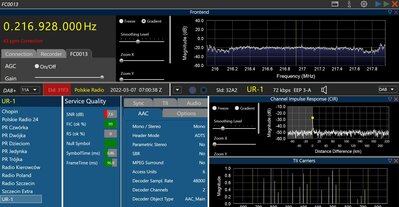

UR-1 sendet in Mono und ohne SBR. 24 CU sind im 11A Kolowo noch frei.
Ensemble 0x31F3, Label: 'Polskie Radio', ShortLabel: 'PolRadio', LTO: +60 min, ECC: 0xE2, NumServices: 13
Audio-Service 0x3211, Label: 'PR Jedynka', ShortLabel: 'Jedynka', PTY: Varied (dynamic), AnnouncementSupport: Yes, Flags: 0x000A [Road Traffic flash, Warning/Service], NumClusters: 2 [1, 2], NumComponents: 1 (Audio: 1, Data: 0)
Audio-Service 0x3222, Label: 'PR Dwójka', ShortLabel: 'Dwójka', PTY: Culture (dynamic), AnnouncementSupport: Yes, Flags: 0x0008 [Warning/Service], NumClusters: 1 [1], NumComponents: 1 (Audio: 1, Data: 0)
AudioComponent, SCIdS: 0, Label: '', ShortLabel: '', ASCTy: 0x3F (AAC), SubChId: 2, StartCU: 84, NumCU: 84, ErrorProt: EEP 3-A (FEC: 1/2), Datarate: 112 kbit/s, NumUserApps: 1
Audio-Service 0x3223, Label: 'Polskie Radio 24', ShortLabel: 'PR 24', PTY: Information (dynamic), AnnouncementSupport: Yes, Flags: 0x0008 [Warning/Service], NumClusters: 1 [1], NumComponents: 1 (Audio: 1, Data: 0)
AudioComponent, SCIdS: 0, Label: '', ShortLabel: '', ASCTy: 0x3F (AAC), SubChId: 6, StartCU: 360, NumCU: 48, ErrorProt: EEP 3-A (FEC: 1/2), Datarate: 64 kbit/s, NumUserApps: 1
Audio-Service 0x3233, Label: 'PR Trójka', ShortLabel: 'Trójka', PTY: Varied (dynamic), AnnouncementSupport: Yes, Flags: 0x0008 [Warning/Service], NumClusters: 1 [1], NumComponents: 1 (Audio: 1, Data: 0)
AudioComponent, SCIdS: 0, Label: '', ShortLabel: '', ASCTy: 0x3F (AAC), SubChId: 3, StartCU: 168, NumCU: 72, ErrorProt: EEP 3-A (FEC: 1/2), Datarate: 96 kbit/s, NumUserApps: 1
Audio-Service 0x32A1, Label: 'Radio Kierowców', ShortLabel: 'R Kierow', PTY: Information (dynamic), AnnouncementSupport: Yes, Flags: 0x000A [Road Traffic flash, Warning/Service], NumClusters: 2 [1, 3], NumComponents: 1 (Audio: 1, Data: 0)
AudioComponent, SCIdS: 0, Label: '', ShortLabel: '', ASCTy: 0x3F (AAC), SubChId: 12, StartCU: 714, NumCU: 72, ErrorProt: EEP 3-A (FEC: 1/2), Datarate: 96 kbit/s, NumUserApps: 1
Audio-Service 0x32A2, Label: 'UR-1', ShortLabel: 'UR-1', PTY: Information (dynamic), AnnouncementSupport: No, NumComponents: 1 (Audio: 1, Data: 0)
AudioComponent, SCIdS: 0, Label: '', ShortLabel: '', ASCTy: 0x3F (AAC), SubChId: 13, StartCU: 786, NumCU: 54, ErrorProt: EEP 3-A (FEC: 1/2), Datarate: 72 kbit/s, NumUserApps: 1
Audio-Service 0x32A3, Label: 'Chopin', ShortLabel: 'Chopin', PTY: Culture (dynamic), AnnouncementSupport: Yes, Flags: 0x0008 [Warning/Service], NumClusters: 1 [1], NumComponents: 1 (Audio: 1, Data: 0)
AudioComponent, SCIdS: 0, Label: '', ShortLabel: '', ASCTy: 0x3F (AAC), SubChId: 7, StartCU: 408, NumCU: 84, ErrorProt: EEP 3-A (FEC: 1/2), Datarate: 112 kbit/s, NumUserApps: 1
Audio-Service 0x32A4, Label: 'PR Dzieciom', ShortLabel: 'Dzieci', PTY: Children's programmes (dynamic), AnnouncementSupport: Yes, Flags: 0x0008 [Warning/Service], NumClusters: 1 [1], NumComponents: 1 (Audio: 1, Data: 0)
AudioComponent, SCIdS: 0, Label: '', ShortLabel: '', ASCTy: 0x3F (AAC), SubChId: 8, StartCU: 492, NumCU: 72, ErrorProt: EEP 3-A (FEC: 1/2), Datarate: 96 kbit/s, NumUserApps: 1
Audio-Service 0x32A5, Label: 'Radio Poland', ShortLabel: 'R Poland', PTY: Information (dynamic), AnnouncementSupport: Yes, Flags: 0x0008 [Warning/Service], NumClusters: 1 [1], NumComponents: 1 (Audio: 1, Data: 0)
AudioComponent, SCIdS: 0, Label: '', ShortLabel: '', ASCTy: 0x3F (AAC), SubChId: 5, StartCU: 312, NumCU: 48, ErrorProt: EEP 3-A (FEC: 1/2), Datarate: 64 kbit/s, NumUserApps: 1
Audio-Service 0x32A6, Label: 'PR Czwórka', ShortLabel: 'Czwórka', PTY: Pop Music (dynamic), AnnouncementSupport: Yes, Flags: 0x0008 [Warning/Service], NumClusters: 1 [1], NumComponents: 1 (Audio: 1, Data: 0)
AudioComponent, SCIdS: 0, Label: '', ShortLabel: '', ASCTy: 0x3F (AAC), SubChId: 4, StartCU: 240, NumCU: 72, ErrorProt: EEP 3-A (FEC: 1/2), Datarate: 96 kbit/s, NumUserApps: 1
Audio-Service 0x34EB, Label: 'Radio Szczecin', ShortLabel: 'Szczecin', PTY: Varied (dynamic), AnnouncementSupport: Yes, Flags: 0x0008 [Warning/Service], NumClusters: 1 [1], NumComponents: 1 (Audio: 1, Data: 0)
AudioComponent, SCIdS: 0, Label: '', ShortLabel: '', ASCTy: 0x3F (AAC), SubChId: 11, StartCU: 630, NumCU: 84, ErrorProt: EEP 3-A (FEC: 1/2), Datarate: 112 kbit/s, NumUserApps: 1
Audio-Service 0x34EC, Label: 'Szczecin Extra', ShortLabel: 'Scxtra', PTY: Varied (dynamic), AnnouncementSupport: Yes, Flags: 0x0008 [Warning/Service], NumClusters: 1 [1], NumComponents: 1 (Audio: 1, Data: 0)
AudioComponent, SCIdS: 0, Label: '', ShortLabel: '', ASCTy: 0x3F (AAC), SubChId: 9, StartCU: 564, NumCU: 54, ErrorProt: EEP 3-A (FEC: 1/2), Datarate: 72 kbit/s, NumUserApps: 1
Data-Service 0xE23033FE, Label: 'EPG', ShortLabel: 'EPG', PTY: -, AnnouncementSupport: No, NumComponents: 1 (Audio: 0, Data: 1)
DataComponent (MSC packet data), SCIdS: 0, SCId: 12, Label: '', ShortLabel: '', DSCTy: 0x3C (MOT), SubChId: 10, StartCU: 618, NumCU: 12, ErrorProt: EEP 3-A (FEC: 1/2), Datarate: 16 kbit/s, PacketAddr: 1, NumUserApps: 1
11AKolowo.jpg [ 240.87 KiB | 7123-mal betrachtet ]
