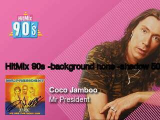

Nent im 7C Malmoe nun doch wieder mit einem Programm fuer Musik der 90er. :-)
Rainbow wurde ersetzt.
Ensemble 0xE205, Label: 'NENT GROUP', ShortLabel: 'NENT GRP', LTO: +120 min, ECC: 0xE3, NumServices: 14
Audio-Service 0xE241, Label: 'RIX FM', ShortLabel: 'RIX FM', PTY: Pop Music (dynamic), AnnouncementSupport: No, NumComponents: 1 (Audio: 1, Data: 0)
Audio-Service 0xE245, Label: 'STAR FM', ShortLabel: 'STAR FM', PTY: Pop Music (dynamic), AnnouncementSupport: No, NumComponents: 1 (Audio: 1, Data: 0)
AudioComponent, SCIdS: 0, Label: '', ShortLabel: '', ASCTy: 0x3F (AAC), SubChId: 2, StartCU: 72, NumCU: 72, ErrorProt: EEP 3-A (FEC: 1/2), Datarate: 96 kbit/s, NumUserApps: 1
Audio-Service 0xE251, Label: 'GAMLA FAVORITER', ShortLabel: 'GAMLA', PTY: Pop Music (dynamic), AnnouncementSupport: No, NumComponents: 1 (Audio: 1, Data: 0)
AudioComponent, SCIdS: 0, Label: '', ShortLabel: '', ASCTy: 0x3F (AAC), SubChId: 6, StartCU: 360, NumCU: 60, ErrorProt: EEP 3-A (FEC: 1/2), Datarate: 80 kbit/s, NumUserApps: 1
Audio-Service 0xE252, Label: 'BANDIT CLASSIC', ShortLabel: 'BANDIT C', PTY: Rock Music (dynamic), AnnouncementSupport: No, NumComponents: 1 (Audio: 1, Data: 0)
AudioComponent, SCIdS: 0, Label: '', ShortLabel: '', ASCTy: 0x3F (AAC), SubChId: 7, StartCU: 420, NumCU: 60, ErrorProt: EEP 3-A (FEC: 1/2), Datarate: 80 kbit/s, NumUserApps: 1
Audio-Service 0xE253, Label: 'GO COUNTRY', ShortLabel: 'COUNTRY', PTY: Country Music (dynamic), AnnouncementSupport: No, NumComponents: 1 (Audio: 1, Data: 0)
AudioComponent, SCIdS: 0, Label: '', ShortLabel: '', ASCTy: 0x3F (AAC), SubChId: 8, StartCU: 480, NumCU: 60, ErrorProt: EEP 3-A (FEC: 1/2), Datarate: 80 kbit/s, NumUserApps: 1
Audio-Service 0xE254, Label: 'HITMIX90's', ShortLabel: 'HITMIX90', PTY: Pop Music (dynamic), AnnouncementSupport: No, NumComponents: 1 (Audio: 1, Data: 0)
AudioComponent, SCIdS: 0, Label: '', ShortLabel: '', ASCTy: 0x3F (AAC), SubChId: 9, StartCU: 540, NumCU: 60, ErrorProt: EEP 3-A (FEC: 1/2), Datarate: 80 kbit/s, NumUserApps: 1
Audio-Service 0xE255, Label: 'SVENSKA FAVORIT', ShortLabel: 'SVENSKA', PTY: Pop Music (dynamic), AnnouncementSupport: No, NumComponents: 1 (Audio: 1, Data: 0)
AudioComponent, SCIdS: 0, Label: '', ShortLabel: '', ASCTy: 0x3F (AAC), SubChId: 10, StartCU: 600, NumCU: 60, ErrorProt: EEP 3-A (FEC: 1/2), Datarate: 80 kbit/s, NumUserApps: 1
Audio-Service 0xE256, Label: 'RIX FM FRESH', ShortLabel: 'RIXFRESH', PTY: Pop Music (dynamic), AnnouncementSupport: No, NumComponents: 1 (Audio: 1, Data: 0)
AudioComponent, SCIdS: 0, Label: '', ShortLabel: '', ASCTy: 0x3F (AAC), SubChId: 11, StartCU: 660, NumCU: 60, ErrorProt: EEP 3-A (FEC: 1/2), Datarate: 80 kbit/s, NumUserApps: 1
Audio-Service 0xE2A7, Label: 'BANDIT ROCK', ShortLabel: 'BANDIT', PTY: Rock Music (dynamic), AnnouncementSupport: No, NumComponents: 1 (Audio: 1, Data: 0)
AudioComponent, SCIdS: 0, Label: '', ShortLabel: '', ASCTy: 0x3F (AAC), SubChId: 3, StartCU: 144, NumCU: 72, ErrorProt: EEP 3-A (FEC: 1/2), Datarate: 96 kbit/s, NumUserApps: 1
Audio-Service 0xE378, Label: 'GULDKANALEN', ShortLabel: 'GULD', PTY: Pop Music (dynamic), AnnouncementSupport: No, NumComponents: 1 (Audio: 1, Data: 0)
AudioComponent, SCIdS: 0, Label: '', ShortLabel: '', ASCTy: 0x3F (AAC), SubChId: 12, StartCU: 720, NumCU: 60, ErrorProt: EEP 3-A (FEC: 1/2), Datarate: 80 kbit/s, NumUserApps: 1
Audio-Service 0xE379, Label: 'DANSBANDSKANALEN', ShortLabel: 'DANSBAND', PTY: Country Music (dynamic), AnnouncementSupport: No, NumComponents: 1 (Audio: 1, Data: 0)
AudioComponent, SCIdS: 0, Label: '', ShortLabel: '', ASCTy: 0x3F (AAC), SubChId: 14, StartCU: 780, NumCU: 60, ErrorProt: EEP 3-A (FEC: 1/2), Datarate: 80 kbit/s, NumUserApps: 1
Audio-Service 0xE444, Label: 'LUGNA FAVORITER', ShortLabel: 'LUGNA', PTY: Pop Music (dynamic), AnnouncementSupport: No, NumComponents: 1 (Audio: 1, Data: 0)
AudioComponent, SCIdS: 0, Label: '', ShortLabel: '', ASCTy: 0x3F (AAC), SubChId: 4, StartCU: 216, NumCU: 72, ErrorProt: EEP 3-A (FEC: 1/2), Datarate: 96 kbit/s, NumUserApps: 1
Audio-Service 0xE4A4, Label: 'POWER', ShortLabel: 'POWER', PTY: Pop Music (dynamic), AnnouncementSupport: No, NumComponents: 1 (Audio: 1, Data: 0)
AudioComponent, SCIdS: 0, Label: '', ShortLabel: '', ASCTy: 0x3F (AAC), SubChId: 5, StartCU: 288, NumCU: 72, ErrorProt: EEP 3-A (FEC: 1/2), Datarate: 96 kbit/s, NumUserApps: 1
Data-Service 0xE3E00000, Label: 'SPI', ShortLabel: 'SPI', PTY: -, AnnouncementSupport: No, NumComponents: 1 (Audio: 0, Data: 1)
DataComponent (MSC packet data), SCIdS: 0, SCId: 0, Label: '', ShortLabel: '', DSCTy: 0x3C (MOT), SubChId: 13, StartCU: 840, NumCU: 24, ErrorProt: EEP 3-A (FEC: 1/2), Datarate: 32 kbit/s, PacketAddr: 1, NumUserApps: 1
User App 1 / 1, Label: '', ShortLabel: '', UaType: 0x7 (EPG), DataLen: 0 []
1928.jpg [ 12.89 KiB | 4701-mal betrachtet ]
7Cnent.jpg [ 102.01 KiB | 4701-mal betrachtet ]
