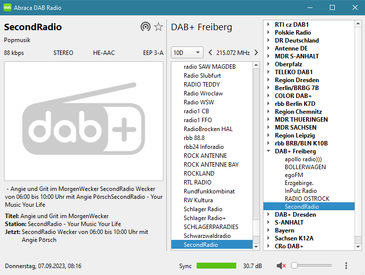

BeitragVerfasst: Do 7. Sep 2023, 08:24
Beiträge: 340
Zufall oder Absicht?
Second Radio und dessen Ableger Radio Ostrock sind wieder auf 10D.
SecondRadio.png [ 57.53 KiB | 5001-mal betrachtet ]
RTL-SDR Blog V.3
Nooelec NESDR SMArt v5
Wittenberg WB345

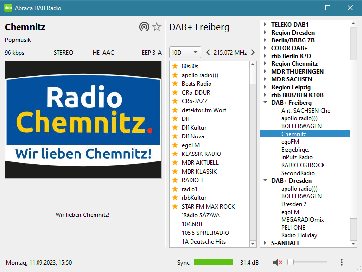

BeitragVerfasst: Mo 11. Sep 2023, 15:52
Beiträge: 340
Antenne Sachsen und Radio Chemnitz sind jetzt auch am Start.
Freiberg.png [ 116.49 KiB | 4918-mal betrachtet ]

 Betreff des Beitrags: Re: Freiberg K10D
BeitragVerfasst: Mo 11. Sep 2023, 16:02
Beiträge: 340
Code:
Ensemble:
0xD124 DAB+ Freiberg [ Freiberg ] ECC: 0xE0, UTC 120 min, INT: 1, alarm announcements: 0
Services (10):
0x1014 egoFM [ egoFM ] ECC: 0xE0, Country: Germany, PTy: Pop Music (static), Announcements: No
AudioComponent (primary), SCIdS: 0, Label: 'egoFM' [ 'egoFM' ], ASCTy: 0x3F (AAC)
      SubChId: 0, Language: Unknown/NA, StartCU: 0, NumCU: 60, EEP 3-A, Coderate: 1/2, Bitrate: 80kbps
0x10C2 SecondRadio [ Second ] ECC: 0xE0, Country: Germany, PTy: Pop Music (static), Announcements: No
AudioComponent (primary), SCIdS: 0, Label: 'SecondRadio' [ 'Second' ], ASCTy: 0x3F (AAC)
      SubChId: 23, Language: Unknown/NA, StartCU: 270, NumCU: 66, EEP 3-A, Coderate: 1/2, Bitrate: 88kbps
0x10CE InPulz Radio [ InPulz ] ECC: 0xE0, Country: Germany, PTy: Pop Music (static), Announcements: No
AudioComponent (primary), SCIdS: 0, Label: 'InPulz Radio' [ 'InPulz' ], ASCTy: 0x3F (AAC)
      SubChId: 1, Language: Unknown/NA, StartCU: 60, NumCU: 60, EEP 3-A, Coderate: 1/2, Bitrate: 80kbps
0x14C8 BOLLERWAGEN [ BOLLER ] ECC: 0xE0, Country: Germany, PTy: Pop Music (static), Announcements: No
AudioComponent (primary), SCIdS: 0, Label: 'BOLLERWAGEN' [ 'BOLLER' ], ASCTy: 0x3F (AAC)
      SubChId: 25, Language: Unknown/NA, StartCU: 402, NumCU: 54, EEP 3-A, Coderate: 1/2, Bitrate: 72kbps
0x16C9 Ant. SACHSEN Che [ AntSN Ch ] ECC: 0xE0, Country: Germany, PTy: Pop Music (static), Announcements: No
AudioComponent (primary), SCIdS: 0, Label: 'Ant. SACHSEN Che' [ 'AntSN Ch' ], ASCTy: 0x3F (AAC)
      SubChId: 27, Language: Unknown/NA, StartCU: 528, NumCU: 66, EEP 3-A, Coderate: 1/2, Bitrate: 88kbps
0x17C1 Chemnitz [ Chemnitz ] ECC: 0xE0, Country: Germany, PTy: Pop Music (static), Announcements: No
AudioComponent (primary), SCIdS: 0, Label: 'Chemnitz' [ 'Chemnitz' ], ASCTy: 0x3F (AAC)
      SubChId: 26, Language: Unknown/NA, StartCU: 456, NumCU: 72, EEP 3-A, Coderate: 1/2, Bitrate: 96kbps
0x19C1 Erzgebirge. [ Erzgeb. ] ECC: 0xE0, Country: Germany, PTy: Pop Music (static), Announcements: No
AudioComponent (primary), SCIdS: 0, Label: 'Erzgebirge.' [ 'Erzgeb.' ], ASCTy: 0x3F (AAC)
      SubChId: 2, Language: Unknown/NA, StartCU: 120, NumCU: 72, EEP 3-A, Coderate: 1/2, Bitrate: 96kbps
0x1AC5 apollo radio))) [ apollo ] ECC: 0xE0, Country: Germany, PTy: Light Classical (static), Announcements: No
AudioComponent (primary), SCIdS: 0, Label: 'apollo radio)))' [ 'apollo' ], ASCTy: 0x3F (AAC)
      SubChId: 24, Language: Unknown/NA, StartCU: 336, NumCU: 66, EEP 3-A, Coderate: 1/2, Bitrate: 88kbps
0x1EC1 RADIO OSTROCK [ OSTROCK ] ECC: 0xE0, Country: Germany, PTy: Oldies Music (static), Announcements: No
AudioComponent (primary), SCIdS: 0, Label: 'RADIO OSTROCK' [ 'OSTROCK' ], ASCTy: 0x3F (AAC)
      SubChId: 22, Language: Unknown/NA, StartCU: 204, NumCU: 66, EEP 3-A, Coderate: 1/2, Bitrate: 88kbps
0xE0D0D124 SPI [ SPI ]
DataComponent (MSC Packet Data) (primary), SCIdS: 0, SCId: 9, Language: Unknown/NA, Label: 'SPI' [ 'SPI' ], DSCTy: 0x3C (MOT), DG: 0, PacketAddr: 1
      SubChId: 20, Language: Unknown/NA, StartCU: 192, NumCU: 12, EEP 3-A [FEC scheme applied], Coderate: 1/2
RTL-SDR Blog V.3
Wittenberg WB345
BeitragVerfasst: Mo 11. Sep 2023, 17:49
Soweit ich informiert bin, soll in Sachen Freiberger Mux morgen noch was passieren.
BeitragVerfasst: Mo 11. Sep 2023, 18:22
Beiträge: 2013
Antenne Sachsen in Freiberg und Chemnitz ohne Titelanzeige. Radio Chemnitz auch. Warum übernimmt man nicht das Signal vom Regionalmux? Auffällig sind auch die Klangunterschiede bei Radio Chemnitz vs Erzgebirge auch im Vergleich zum Regiomux.
Dann fehlt ja jetzt nur noch Radio Dresden von UKW. Warum wird das nicht anstelle von Chemnitz und Erzgebirge gesendet? Letztere beiden warn doch für Freiberg nie zuständig.
