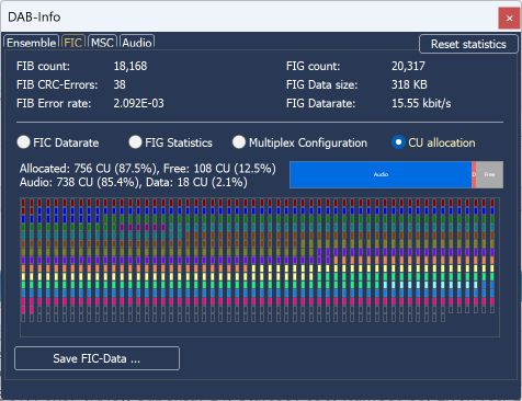

Die Bitraten der Programme im 10B wurden heute angepasst. Es sind bis morgen 108 CU frei.
Ensemble 0x1148, Label: 'rbb BRB/BLN K10B', ShortLabel: 'rbb K10B', LTO: +120 min, ECC: 0xE0, AlarmFlag: 0, NumServices: 14
Audio-Service 0xD321, Label: 'rbb 88.8', ShortLabel: 'rbb 88.8', PTY: Pop Music (dynamic), AnnouncementSupport: Yes, Flags: 0x0002 [Road Traffic flash], NumClusters: 1 [1], NumComponents: 1 (Audio: 1, Data: 0)
AudioComponent, SCIdS: 0, Label: '', ShortLabel: '', ASCTy: 0x3F (AAC), SubChId: 6, StartCU: 324, NumCU: 60, ErrorProt: EEP 3-A (FEC: 1/2), Datarate: 80 kbit/s, NumUserApps: 1
Audio-Service 0xD323, Label: 'radio3 vom rbb', ShortLabel: 'radio3', PTY: Culture (dynamic), AnnouncementSupport: No, NumComponents: 1 (Audio: 1, Data: 0)
AudioComponent, SCIdS: 0, Label: '', ShortLabel: '', ASCTy: 0x3F (AAC), SubChId: 5, StartCU: 252, NumCU: 72, ErrorProt: EEP 3-A (FEC: 1/2), Datarate: 96 kbit/s, NumUserApps: 1
Audio-Service 0xD332, Label: 'radio1', ShortLabel: 'radio1', PTY: Pop Music (dynamic), AnnouncementSupport: Yes, Flags: 0x0002 [Road Traffic flash], NumClusters: 1 [2], NumComponents: 1 (Audio: 1, Data: 0)
AudioComponent, SCIdS: 0, Label: '', ShortLabel: '', ASCTy: 0x3F (AAC), SubChId: 1, StartCU: 60, NumCU: 66, ErrorProt: EEP 3-A (FEC: 1/2), Datarate: 88 kbit/s, NumUserApps: 1
Audio-Service 0xD333, Label: 'Fritz', ShortLabel: 'Fritz', PTY: Pop Music (dynamic), AnnouncementSupport: Yes, Flags: 0x0002 [Road Traffic flash], NumClusters: 1 [12], NumComponents: 1 (Audio: 1, Data: 0)
AudioComponent, SCIdS: 0, Label: '', ShortLabel: '', ASCTy: 0x3F (AAC), SubChId: 7, StartCU: 384, NumCU: 60, ErrorProt: EEP 3-A (FEC: 1/2), Datarate: 80 kbit/s, NumUserApps: 1
Audio-Service 0xD335, Label: 'rbb24 Inforadio', ShortLabel: 'Info', PTY: Information (dynamic), AnnouncementSupport: Yes, Flags: 0x0002 [Road Traffic flash], NumClusters: 1 [4], NumComponents: 1 (Audio: 1, Data: 0)
AudioComponent, SCIdS: 0, Label: '', ShortLabel: '', ASCTy: 0x3F (AAC), SubChId: 8, StartCU: 444, NumCU: 48, ErrorProt: EEP 3-A (FEC: 1/2), Datarate: 64 kbit/s, NumUserApps: 1
Audio-Service 0xD431, Label: 'Antenne P', ShortLabel: 'Ant P', PTY: Pop Music (dynamic), AnnouncementSupport: Yes, Flags: 0x0002 [Road Traffic flash], NumClusters: 1 [3], NumComponents: 1 (Audio: 1, Data: 0)
AudioComponent, SCIdS: 0, Label: '', ShortLabel: '', ASCTy: 0x3F (AAC), SubChId: 0, StartCU: 0, NumCU: 60, ErrorProt: EEP 3-A (FEC: 1/2), Datarate: 80 kbit/s, NumUserApps: 1
Audio-Service 0xD531, Label: 'Antenne CB', ShortLabel: 'Ant CB', PTY: Pop Music (dynamic), AnnouncementSupport: Yes, Flags: 0x0002 [Road Traffic flash], NumClusters: 1 [10], NumComponents: 1 (Audio: 1, Data: 0)
AudioComponent, SCIdS: 0, Label: '', ShortLabel: '', ASCTy: 0x3F (AAC), SubChId: 4, StartCU: 192, NumCU: 60, ErrorProt: EEP 3-A (FEC: 1/2), Datarate: 80 kbit/s, NumUserApps: 1
Audio-Service 0xD532, Label: 'radio1 CB', ShortLabel: 'radio1CB', PTY: Pop Music (dynamic), AnnouncementSupport: Yes, Flags: 0x0002 [Road Traffic flash], NumClusters: 1 [13], NumComponents: 1 (Audio: 1, Data: 0)
AudioComponent, SCIdS: 0, Label: '', ShortLabel: '', ASCTy: 0x3F (AAC), SubChId: 9, StartCU: 492, NumCU: 66, ErrorProt: EEP 3-A (FEC: 1/2), Datarate: 88 kbit/s, NumUserApps: 1
Audio-Service 0xD631, Label: 'Antenne FFO', ShortLabel: 'Ant FFO', PTY: Pop Music (dynamic), AnnouncementSupport: Yes, Flags: 0x0002 [Road Traffic flash], NumClusters: 1 [9], NumComponents: 1 (Audio: 1, Data: 0)
AudioComponent, SCIdS: 0, Label: '', ShortLabel: '', ASCTy: 0x3F (AAC), SubChId: 2, StartCU: 126, NumCU: 60, ErrorProt: EEP 3-A (FEC: 1/2), Datarate: 80 kbit/s, NumUserApps: 1
Audio-Service 0xD632, Label: 'radio1 FFO', ShortLabel: 'radio1FO', PTY: Pop Music (dynamic), AnnouncementSupport: Yes, Flags: 0x0002 [Road Traffic flash], NumClusters: 1 [14], NumComponents: 1 (Audio: 1, Data: 0)
AudioComponent, SCIdS: 0, Label: '', ShortLabel: '', ASCTy: 0x3F (AAC), SubChId: 10, StartCU: 558, NumCU: 66, ErrorProt: EEP 3-A (FEC: 1/2), Datarate: 88 kbit/s, NumUserApps: 1
Audio-Service 0xD731, Label: 'Antenne PZL', ShortLabel: 'Ant PZL', PTY: Pop Music (dynamic), AnnouncementSupport: Yes, Flags: 0x0002 [Road Traffic flash], NumClusters: 1 [11], NumComponents: 1 (Audio: 1, Data: 0)
AudioComponent, SCIdS: 0, Label: '', ShortLabel: '', ASCTy: 0x3F (AAC), SubChId: 14, StartCU: 696, NumCU: 60, ErrorProt: EEP 3-A (FEC: 1/2), Datarate: 80 kbit/s, NumUserApps: 1
Audio-Service 0xD831, Label: 'Antenne PBG', ShortLabel: 'Ant PBG', PTY: Pop Music (dynamic), AnnouncementSupport: Yes, Flags: 0x0002 [Road Traffic flash], NumClusters: 1 [7], NumComponents: 1 (Audio: 1, Data: 0)
AudioComponent, SCIdS: 0, Label: '', ShortLabel: '', ASCTy: 0x3F (AAC), SubChId: 12, StartCU: 636, NumCU: 60, ErrorProt: EEP 3-A (FEC: 1/2), Datarate: 80 kbit/s, NumUserApps: 1
Data-Service 0xE0D01148, Label: 'rbb TPEG', ShortLabel: 'TPEG', PTY: -, AnnouncementSupport: No, NumComponents: 1 (Audio: 0, Data: 1)
DataComponent (MSC packet data), SCIdS: 0, SCId: 0, Label: '', ShortLabel: '', DSCTy: 0x05 (Transparent Data Channel), SubChId: 3, StartCU: 186, NumCU: 6, ErrorProt: EEP 3-A (FEC: 1/2), Datarate: 8 kbit/s, PacketAddr: 1, NumUserApps: 1
Data-Service 0xE0D11148, Label: 'rbb EPG', ShortLabel: 'EPG', PTY: -, AnnouncementSupport: No, NumComponents: 1 (Audio: 0, Data: 1)
DataComponent (MSC packet data), SCIdS: 0, SCId: 1, Label: '', ShortLabel: '', DSCTy: 0x3C (MOT), SubChId: 11, StartCU: 624, NumCU: 12, ErrorProt: EEP 3-A (FEC: 1/2), Datarate: 16 kbit/s, PacketAddr: 2, NumUserApps: 1
10Brbb.jpg [ 41.33 KiB | 3747-mal betrachtet ]

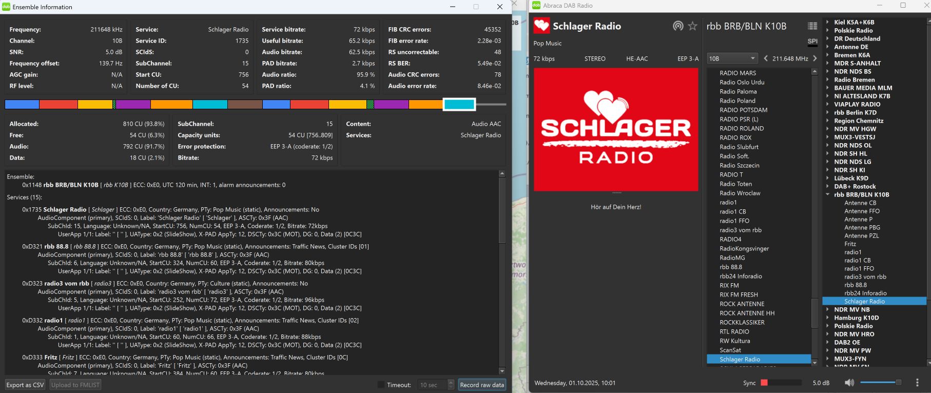

Schlagerradio ist jetzt drauf. rs2 noch nicht.
Edit rs2 fehlt noch immer.
10Brbb.jpg [ 220.32 KiB | 3689-mal betrachtet ]
